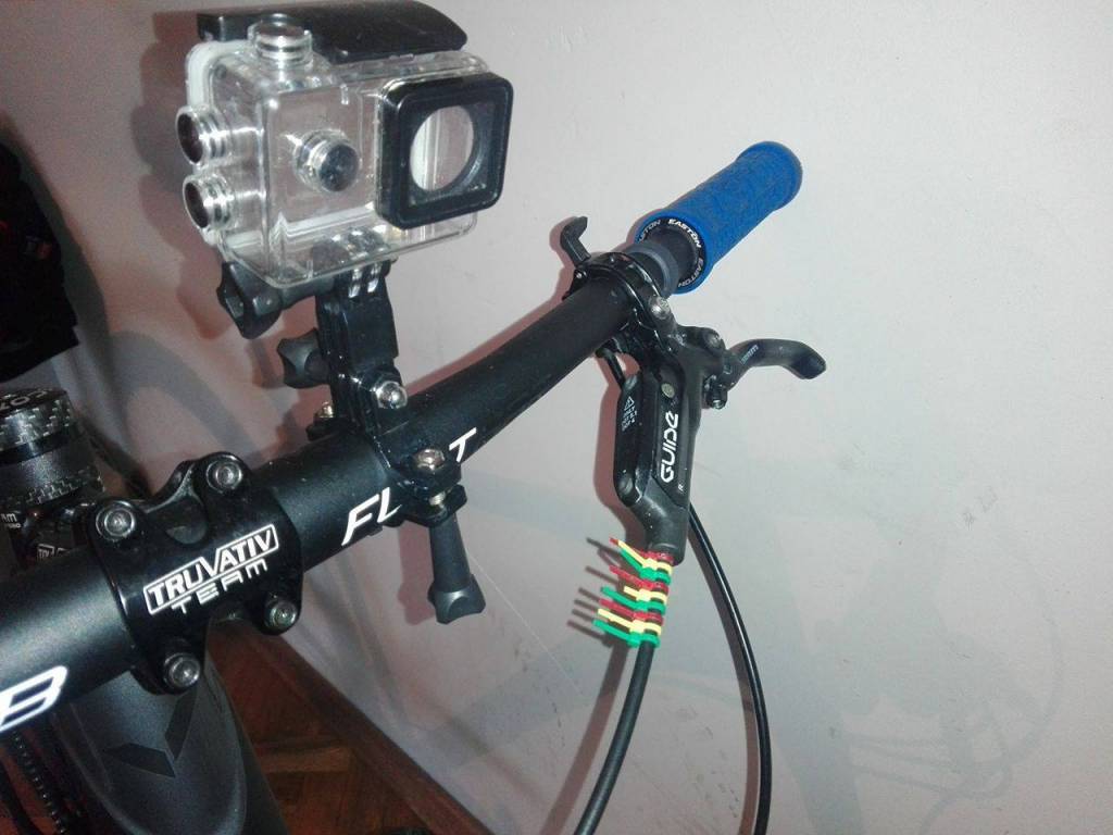

  8. Kierownica BBB FLAT 760mm
  9. Mostek Truvativ TEAM
  10. Chwyty Easton                                                                                                                                                                                                  19551603_1440850852643002_1097704933_o.thumb.jpg.79393a1fb2ed867a95b4d4feb3625c74.jpg19551340_1440850922642995_27695497_o.thumb.jpg.04ede8da7255e14c905bf941bfdecebf.jpg19619666_1440850895976331_2038255764_o.thumb.jpg.1c7c7f472d427a9a5b724ff6b35bbd1d.jpg
