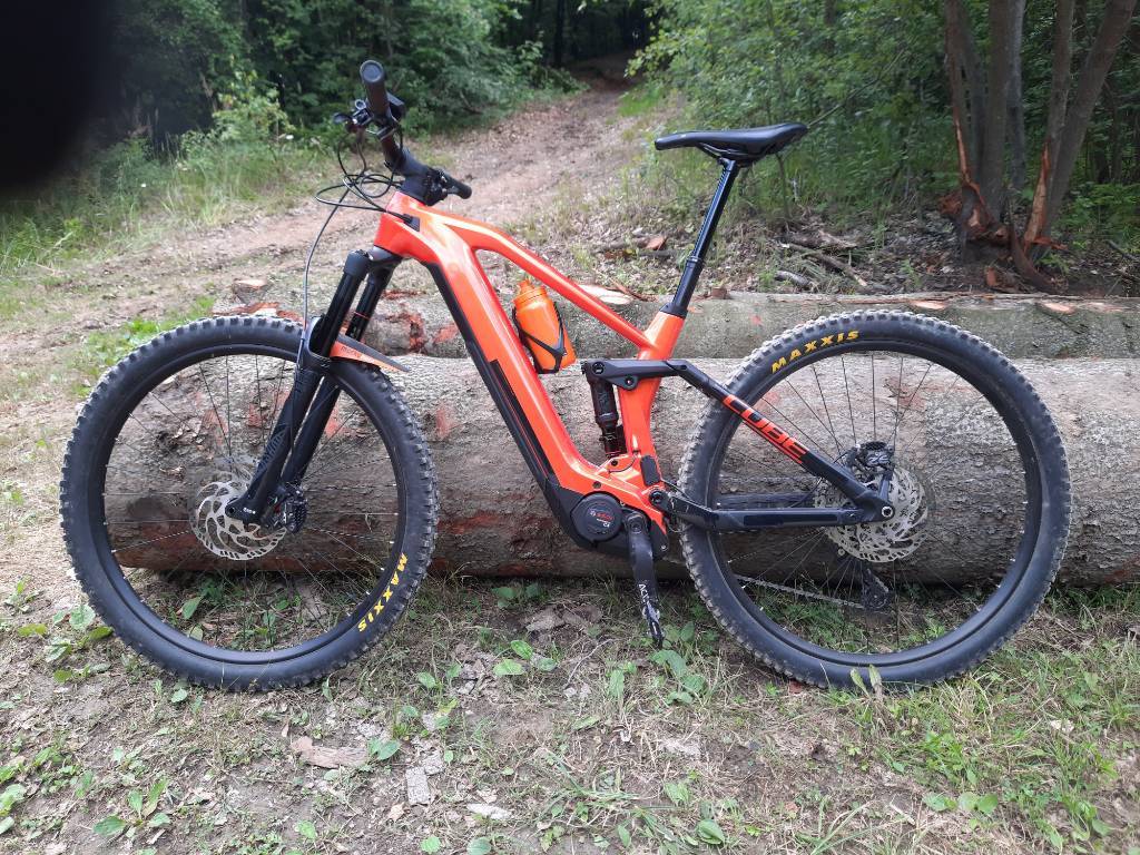

Rower zakupiony w czerwcu 2022 r, po kolejnych zmianach specyfikacji:
RAMA Karbon Monocoque Advanced Twin Mold Technology, tylny trójkąt Aluminium 6061 T6, Efficient Trail Control, FSP 4-Link, Agile Trail Geometry, Boost 148, zintegrowana bateria
ROZMIAR M (18")
WIDELEC RockShox Lyrik Ultimate Charger 2.1, Tapered, 15x110mm, 160mm
TŁUMIK RockShox SUPER DELUXE ULTIMATE RCT, 185x55mm + MegNeg
UKŁAD NAPĘDOWY Bosch Drive Unit Performance CX Generation 4 (85Nm) Cruise (250Watt)
AKUMULATOR Bosch PowerTube 625
WYŚWIETLACZ Bosch Nyon
ŁADOWARKA Bosch 2A
UKŁAD HAMULCOWY Shimano XT 4-ro tłoczkowy M8020, tylny zacisk ZEE, tarcze Sram HS2 CL 220/203 mm
TYLNA PRZERZUTKA Shimano Deore RD-M5100-SGS, 11-Speed
MANETKI Shimano Deore SL-M5100, Rapidfire-Plus
KORBA ACID E-Crank, 175mm 34T
PROWADNICA ŁAŃCUCHA e*thirteen Plus e*spec
KASETA Shimano Deore CS-M5100, 11-51T
ŁAŃCUCH Shimano CN-E8000
PRZEDNIA PIASTA Shimano HB-MT400-B, 15mm, Boost, Centerlock
PIASTA TYLNA Shimano FH-MT400-B, 12mm, Boost, Centerlock
OBRĘCZ przód CUBE EX30, tył Dartmoor Shield Wide
OPONY Tył Opona CONTINENTAL Kryptotal RE 29x2.40 Downhill Casing + wkładka DARK.BIKE Flatkilla przód Continental Argotal Trail Endurance 29x2,60
MOSTEK CUBE Performance Stem E-MTB, 31.8mm
KIEROWNICA Newmen Evolution SL 318.25, 760mm
CHWYTY Ergon GA2
SZTYCA PODSIODŁOWA KIND SHOCK RAGE Integra 31,6 170 / 495mm
ZACISK SZTYCY CUBE Screwlock Semi Integrated, 34.9mm
SIODEŁKO Natural Fit Sequence
PEDAŁY CRANKBROTHERS Mallet 3
ŁOŻYSKA STEROWE ACROS AZX-1030, Top Zero-Stack 1 1/2" (ZS 56mm), Bottom Zero-Stack 1 1/2" (ZS 56mm)
WAGA 24,2 kg
KOLOR sparkorange´n´black
